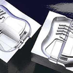

  • Material: H-13
  • Machining Time: Rough – 55 min, Semi-Finish – 15 min, Finish – 87 min, Total – 157 min
  • Spindle Speed: 25,000~35,000 RPM
  • Hardness: 50-52 Rc
