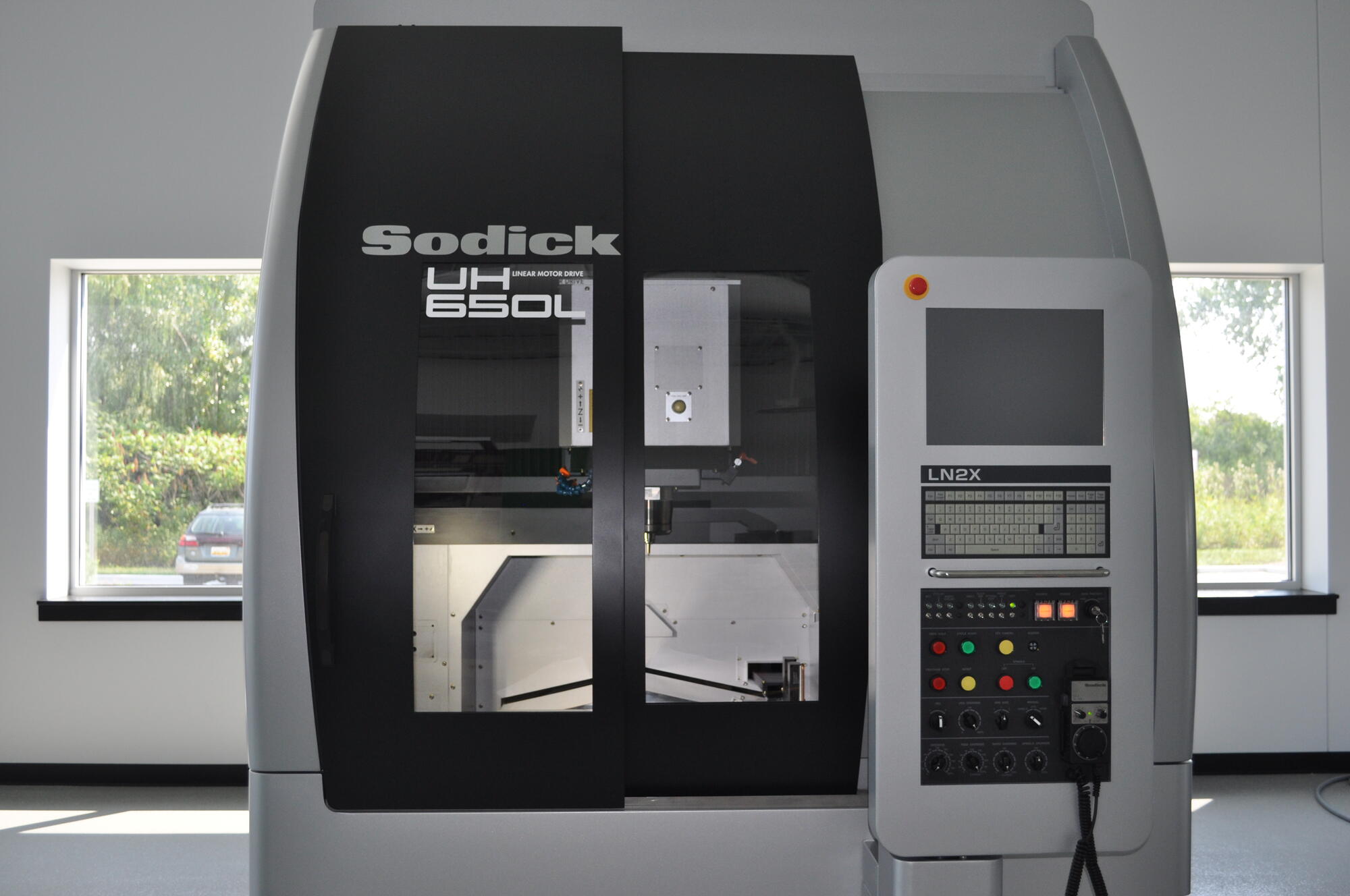

Ultra High Speed Vertical Mill

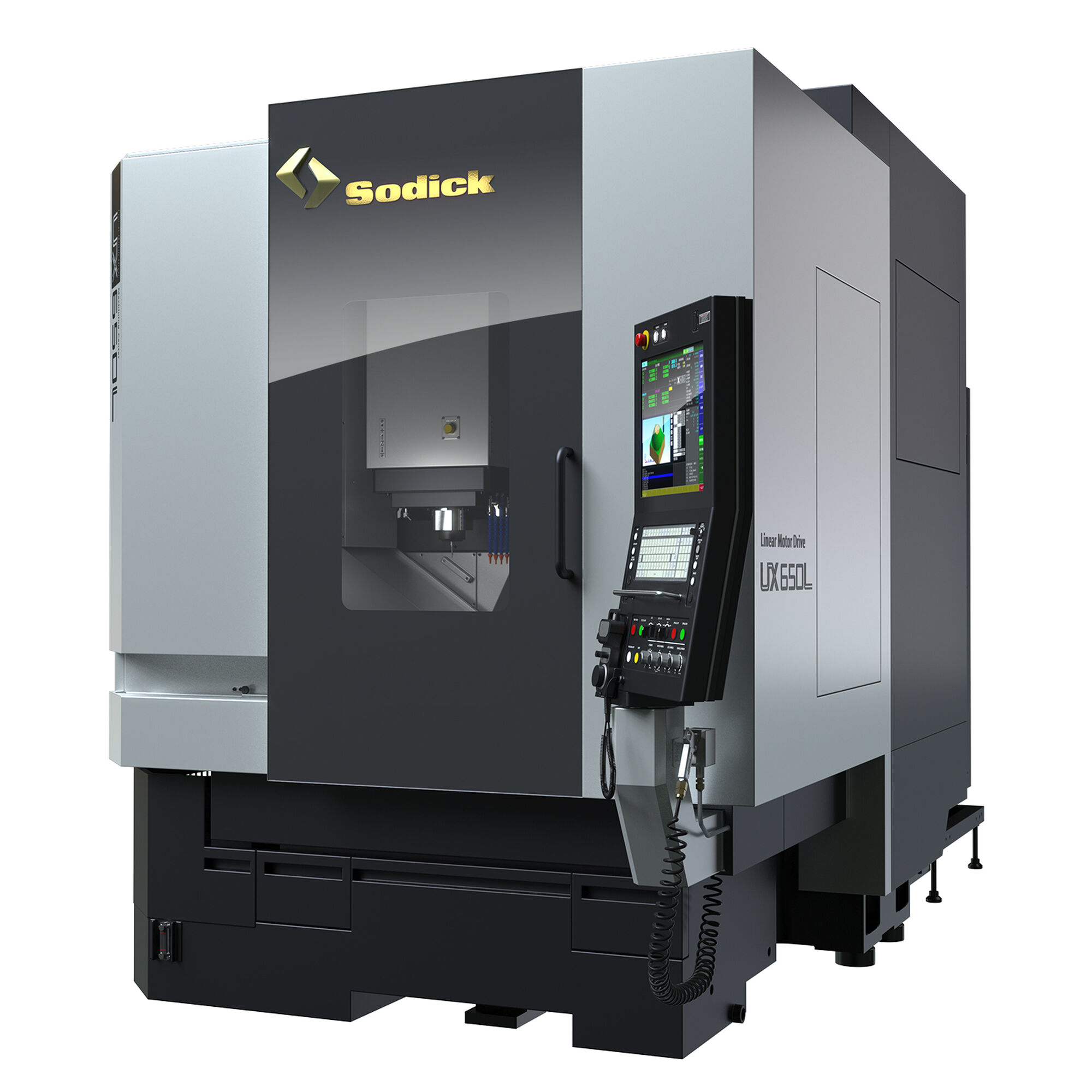

The UX650L is designed and built for high-speed precision milling. Sodick’s linear motor technology provides instantaneous servo time, achieving ideal chip load and efficiency. PLUS, gain Jig Grinding capacity without investment in additional, costly equipment.

Sodick’s linear motor driven High Speed Mills have no backlash and are vibration-free, this results in machining accuracy combined with a fine surface finish.

The Sodick UH650L Vertical Machining Center features Sodick’s patented energy saving linear motors and linear scales with five-place decimal input and feedback. This combination results in unsurpassed speed and accuracy with almost zero backlash. This leads to a machine tool that can handle the most complex, three-dimensional contours better than any other machine in its class.
With an impressive acceleration rate of 1G, superior stability and the highest degree of precision down to nanometer are the tip attributes of this innovation. The Sodick HSM has begun a new era in high precision milling. Unlike the conventional method of separately executing rough and fine milling, this new technology combines both machining passes in one operating mode. The solution is a rapidly rotating and traversing of small tool diameter that cuts to very fine depths.
MotionExpert analyzes NC programs created in commercially available CAM systems, estimating accurate machining times, predicting surface quality, and checking for penetration or gouging to prevent damage to the machine and tools. MotionExpert is fully compatible with Windows-based PCs

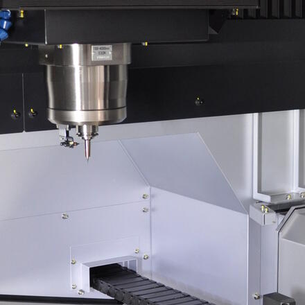

The UH650L features a 1,500 - 40,000 RPM spindle, standard. HSK-E25 options are available with a max rpm of up to 60,000. This spindle is ideal for high-speed, high-precision direct milling of hard surfaces and features a long spindle life. The spindle is high-torque and highly durable and includes micro-oil mist lubrication.

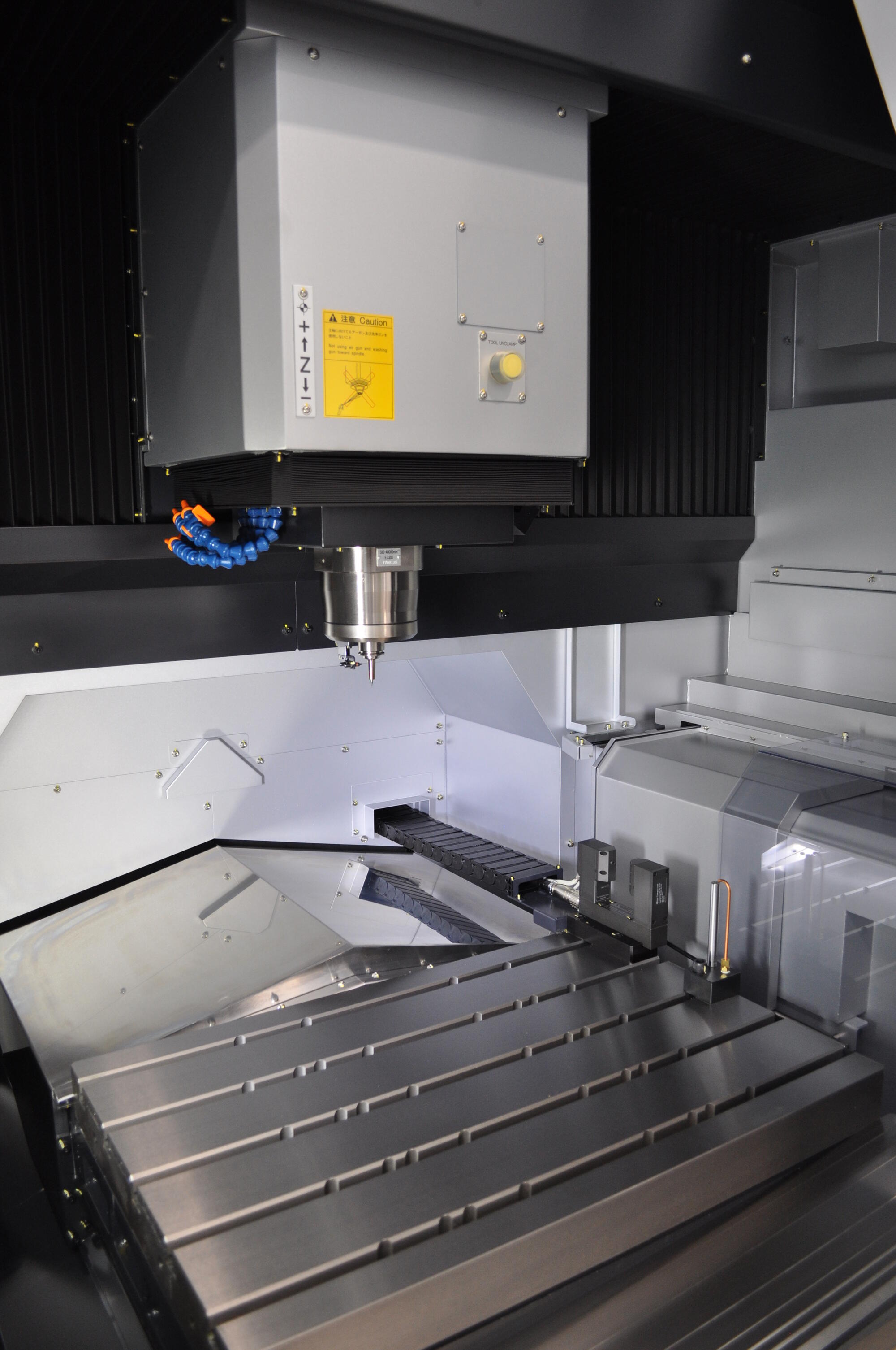

The symmetrical “gate-type double column” structure keeps thermal displacement generated by the spindle within 3 μm. It features bridge construction made of FC300 cast iron and FCD-500 spheroidal cast iron. These materials provide excellent shock and vibration dampening as well as minimal thermal distortion in normal working environments. The machine’s bridge construction reduces the distance from spindle center to the Z-Axis guide ways, minimizing the opportunity for thermal distortion and simultaneously producing extreme rigidity. Bridge construction also eliminates the X-Axis table overhang commonly associated with C-frame construction.
Sodick’s new Jig Grinding function provides the UH Series the flexibility to perform high-precision, 3-axis grinding applications with ease. With independent Z-motion and high feed rate, the UH can achieve high surface quality along difficult contours. With this added capability, the UH series can eliminate the need for expensive, single-function jig grinders.
With the added capability of Sodick’s new High-Speed Drilling function the UH mill excels in production hole drilling, even with tight tolerance requirements. Through the use of a high speed cycle macro, production time on drilled holes can be cut in half.
A large 15.1” display screen incorporates a resistance-sensitive touch screen CNC. Within the display, mode selection buttons are on the right-edge of the screen, and function buttons are along the bottom-edge. Also equipped with a full keyboard, these elements together create a PC-like feel and instant familiarity allows for intuitive operation.
