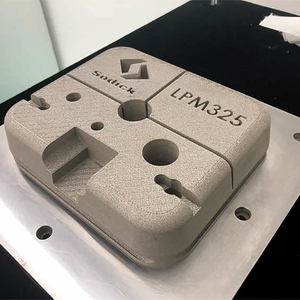

The molding efficiency for the injection molding of plastic products is significantly affected by the structure of the mold used. Temperature control inside the mold is important and the LPM325 allows 3D cooling channels to be freely arranged inside the mold. This resolves issues with uneven cooling of the mold and permits previously unheard of ultra-high-cycle operation and allows optimization of the molding shrinkage factor.

The LPM325 comes with a parallel mode function, enabling simultaneous printing at multiple locations by controlling a single laser at high speed. Cavities and cores printed in the parallel mode can be created with built-in 3D cooling channels that are effective for high- cycle molding.
