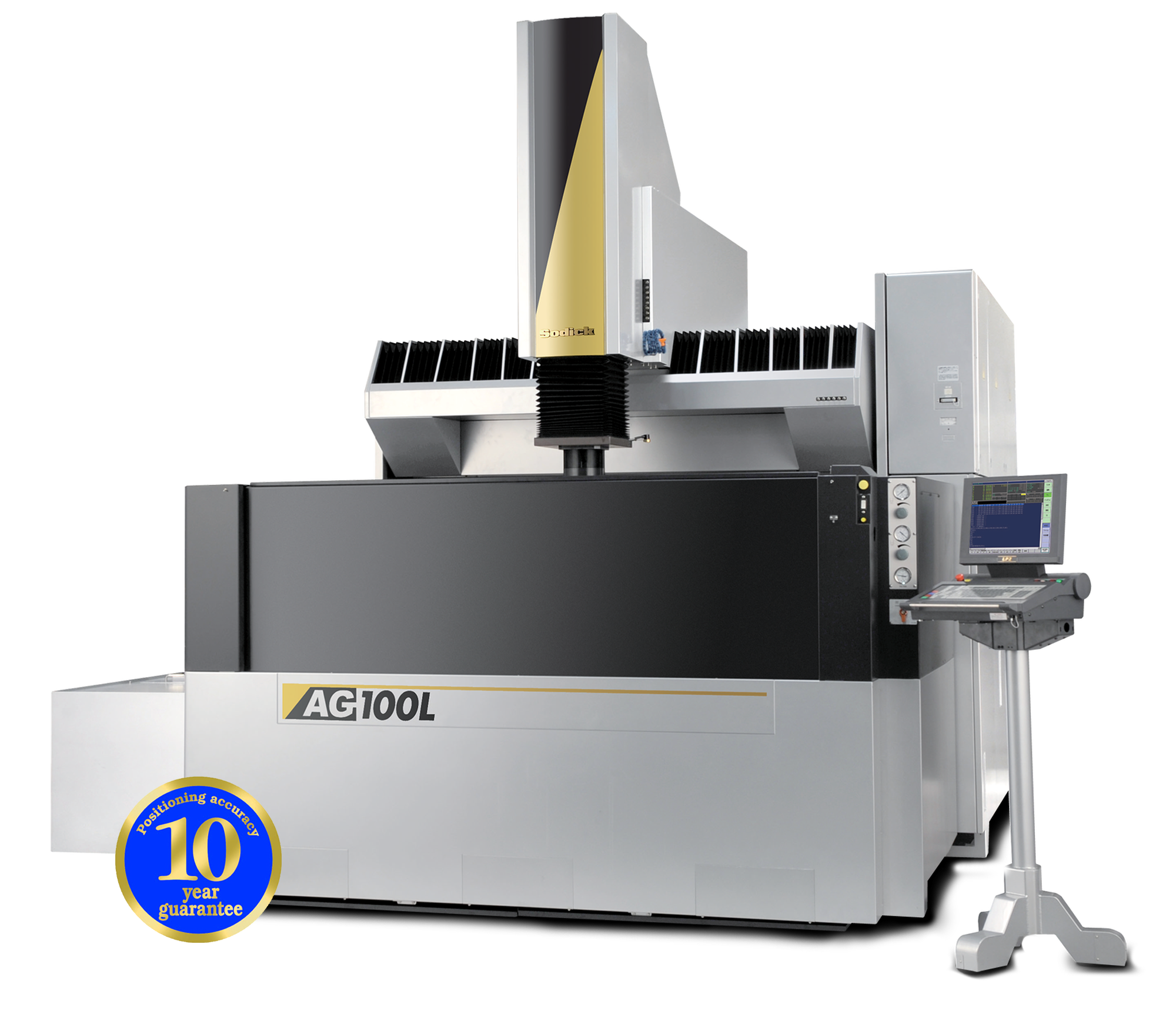

Sodick presents the large AG Sinker-EDM, the AG100L. Needless to say, the model features all the in-house made technologies of Sodick.

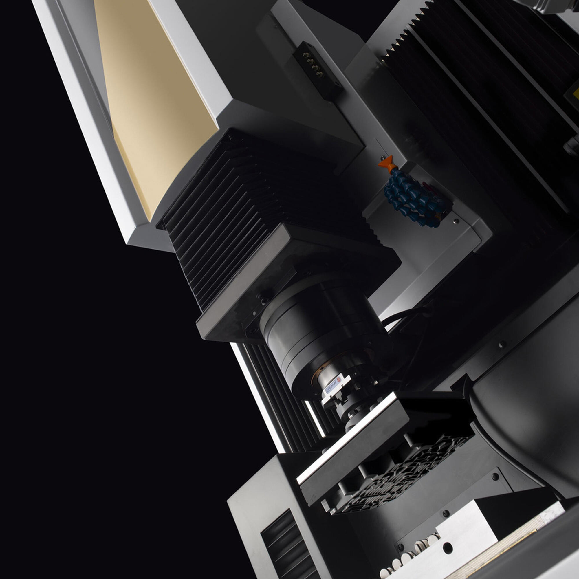

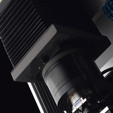

The AG series features linear drive technology and simplified control mechanisms, which provide a direct link between the drive and the control. This ensures the fastest possible servo response and optimal spark gaps at all times

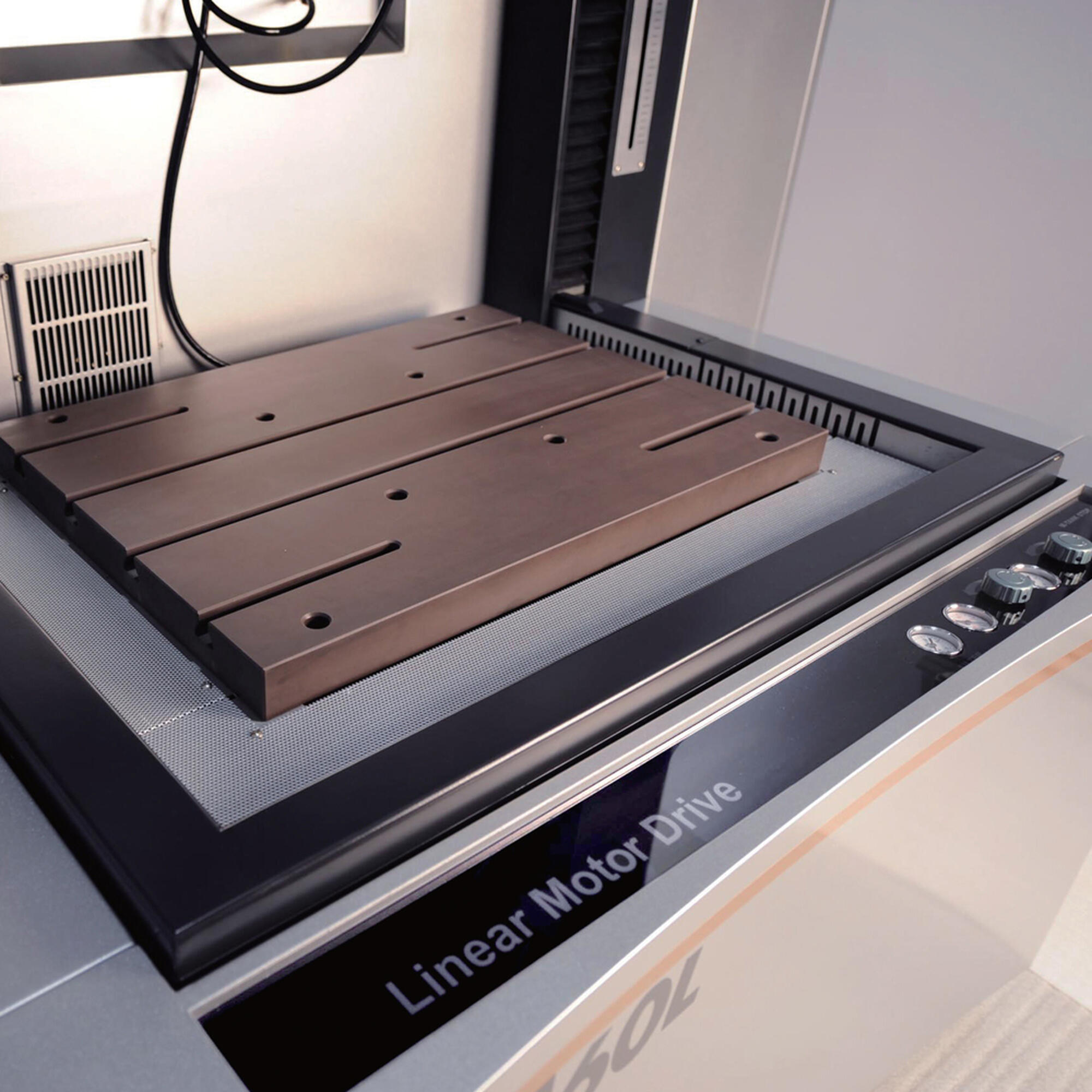

The AG100L Sinker EDM features Sodick’s Linear Motor Drives. Linear motor drives have been a perfect fit for CNC Sinker EDMs (Electrical Discharge Machines). The linear motor’s fast 1,400”/min axis feed combined with high 1.2G acceleration creates its own natural and even flushing condition. The positioning accuracy of Sodick’s linear motors are guaranteed for 10 years on all Wire and Sinker EDMs.
The LN Series power supply unit incorporates all functions necessary for high-speed, high-precision and high-efficiency EDMing. It incorporates a CF card for data storage to enhance reliability and to save energy. The ease of operation has been further enhanced with the newly designed operation and control panel, which provides touch-screen operation and LAN function. The LN professional automatic programming system offers a wide variety of machining shape patterns that can be used in various kinds of machining.
The AG Series features energy-saving designs and technologies. Compared to conventional EDMs, the Sodick Sinker EDM Range can reduce average energy consumption by up to 60%.
The new electrical discharge circuit "Arc-less," is standard on the AG100L and enables no-arc machining. It greatly reduces the machining cycle time and the number of electrodes used, leading to a dramatic reduction of cost and human errors.
Even with copper electrodes, the machining speed and accuracy can be greatly improved with the use of the "SVC" Circuit. Voltage is controlled by the "SVC" Circuit, therefore the surface finish can be uniformly and efficiently controlled to provide a high-grade texture or mirror surface finish in a very short period of time, up to 4 times faster than conventional EDMs.
