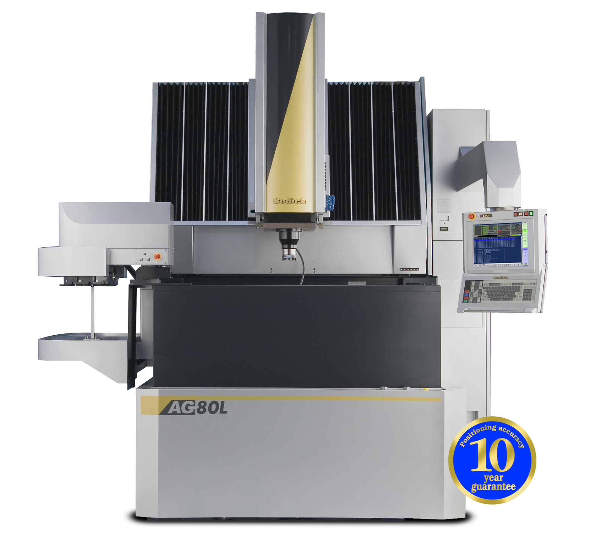

Sodick’s largest size Die sinker EDM machine in the range is the “AG80L”. It is suitable for cutting large work pieces in a very short space of time, thanks to the Sodick’s in-house fabricated technologies.
The series features linear drive technology and simplified control mechanisms, which provide a direct link between the drive and the control. This ensures the fastest possible servo response and optimal spark gaps at all times.

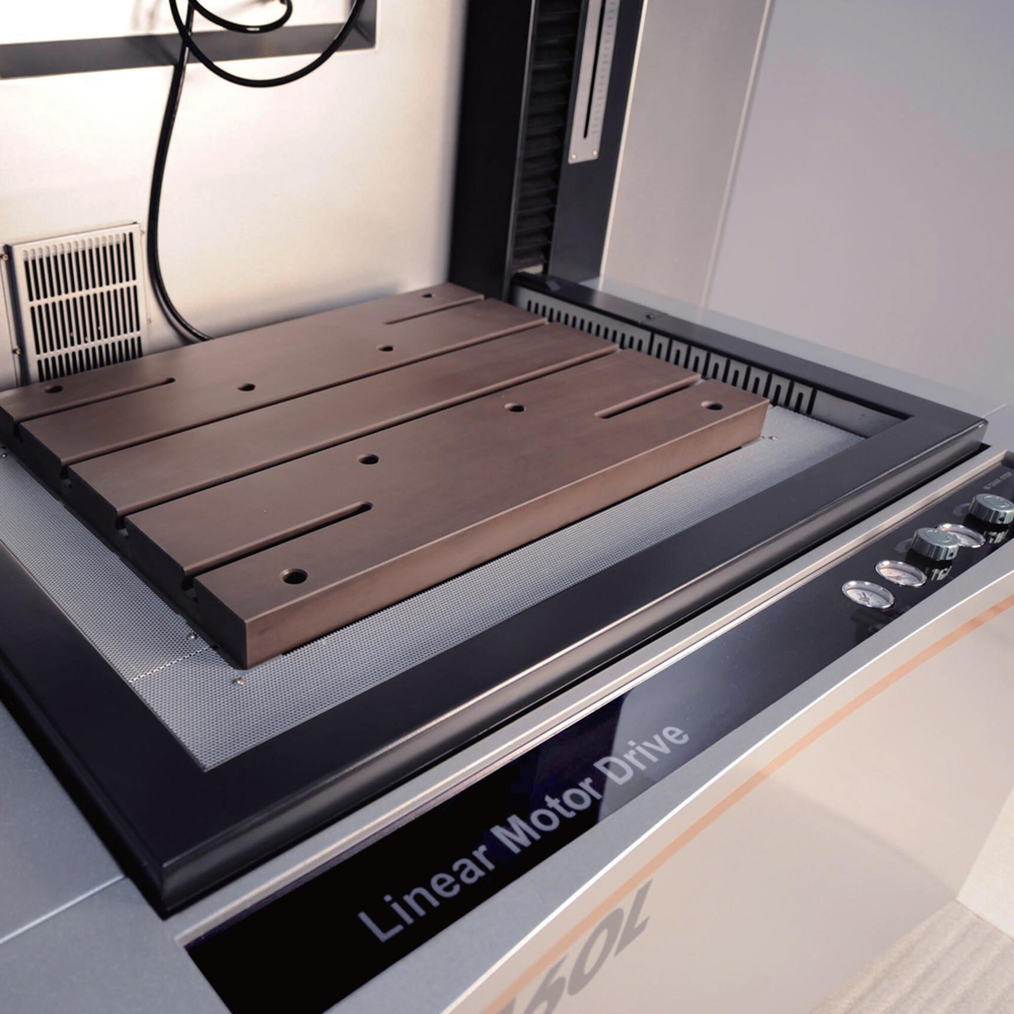

The AG80L Sinker EDM features Sodick’s Linear Motor Drives. Linear motor drives have been a perfect fit for CNC RAM EDMs (Electrical Discharge Machines). The linear motor’s fast 1,400”/min axis feed combined with high 1.2G acceleration creates its own natural and even flushing condition. The positioning accuracy of Sodick’s linear motors are guaranteed for 10 years on all Wire and Sinker EDMs.

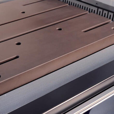

| Table dimensions (W x D, mm): | 1100 x 700 (Ceramic) |
