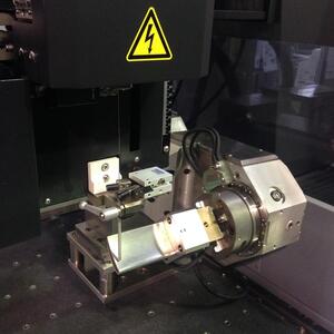

The K3HN is a high speed small hole driller EDM machine that drills difficult to cut carbide and heat treated workpieces. The K3HN is often used as a production machine to EDM start holes in die plates and is sometimes combined with an auxiliary axis to index or rotate a workpiece.

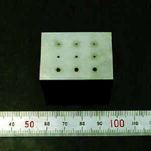

  • Material: STAVAX
  • Thickness: .79” (20 mm)
  • Electrode Material: Copper (Cu) Pipe
  • Electrode Diameter: Φ0.02” (Φ0.5 mm), Φ 0.039” (Φ1.0 mm), Φ 0.079” (Φ2.0 mm)
  • Dielectric Fluid: Water
