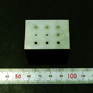

The K3HS is a high speed small hole driller EDM machine that drills difficult to cut carbide and heat treated workpieces. The K3HN is often used as a production machine to EDM start holes in die plates and is sometimes combined with an auxiliary axis to index or rotate a workpiece.
Since the K3HN hole popper is equipped with K-SMC, Sodick Motion Controller, the optimized servo control is activated and improves cutting speed by up to 200%.
Accurate fine feeding is controlled for stable machining.
