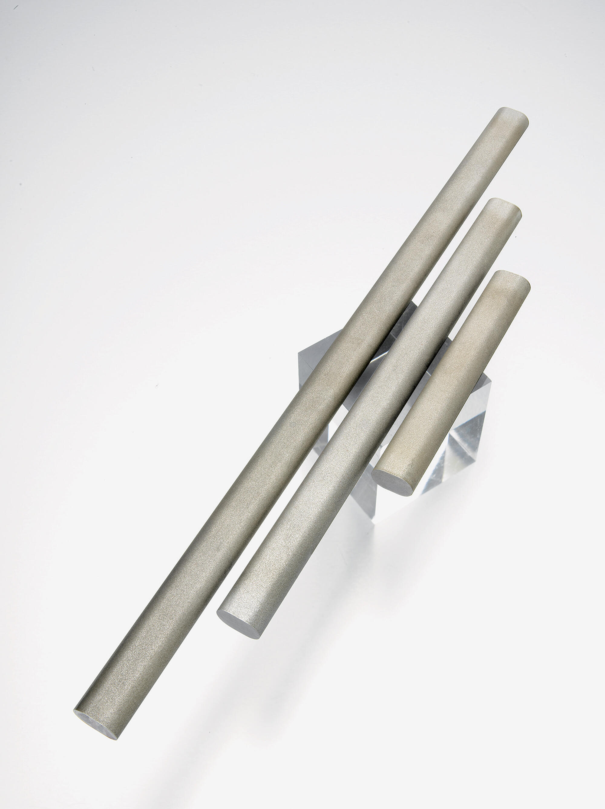

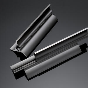

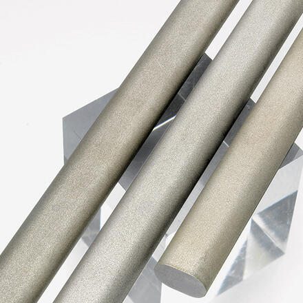

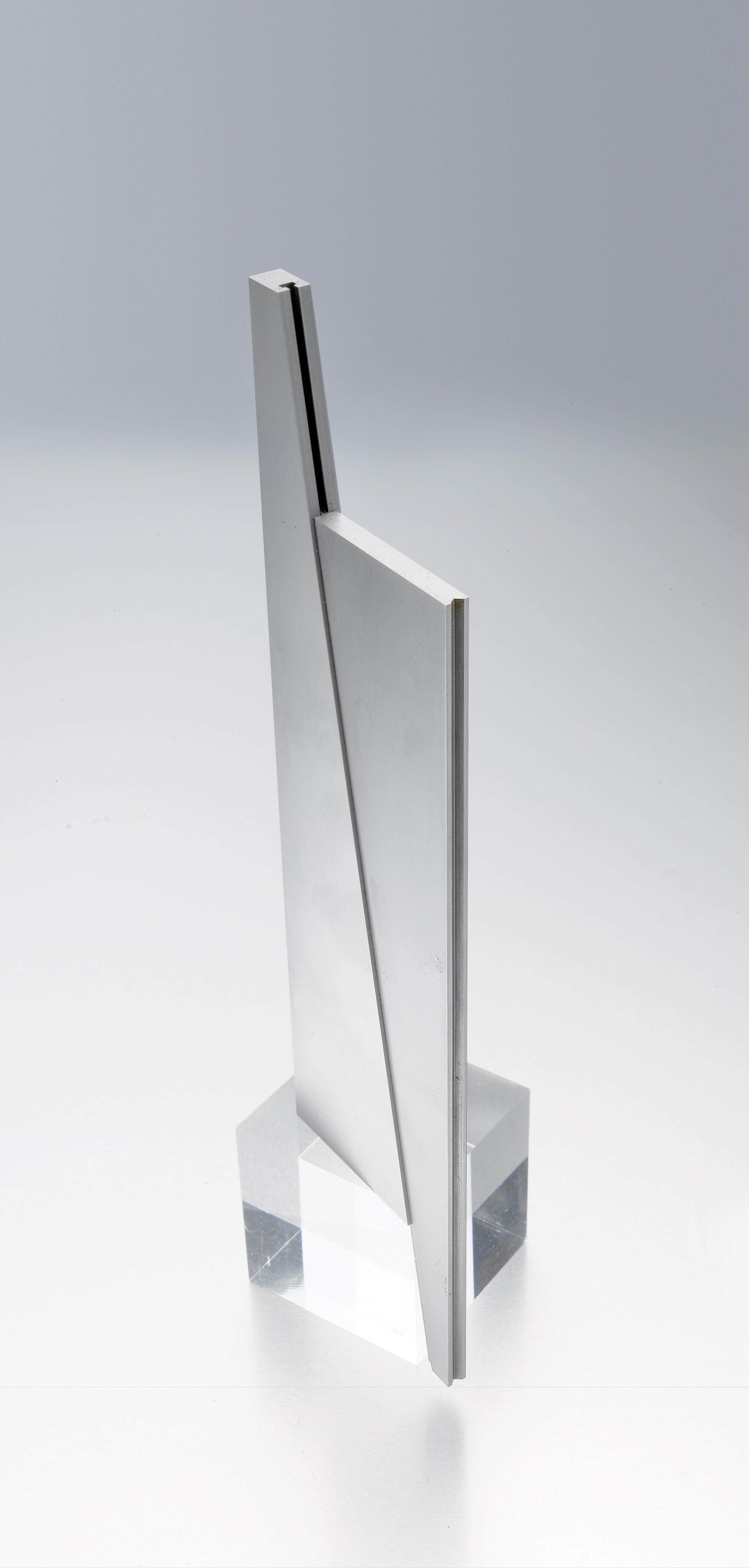

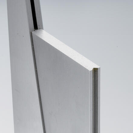

In cutting precision fitting parts with a 3.94" (100 mm) thickness, Sodick has achieved the following; improved cutting speed, reduced cutting frequency, improved part accuracy and improved surface quality. A 32% cutting time reduction has been achieved using the ALC400G.
Thickness: 3.94” (100 mm)
Surface Roughness: 8 RMS (.20 µmRa)
Cutting Accuracy: +/- .00012" (3 µm)
Wire Diameter: .008” (.2 mm)
Cutting Time: 2 hours 57 minutes
