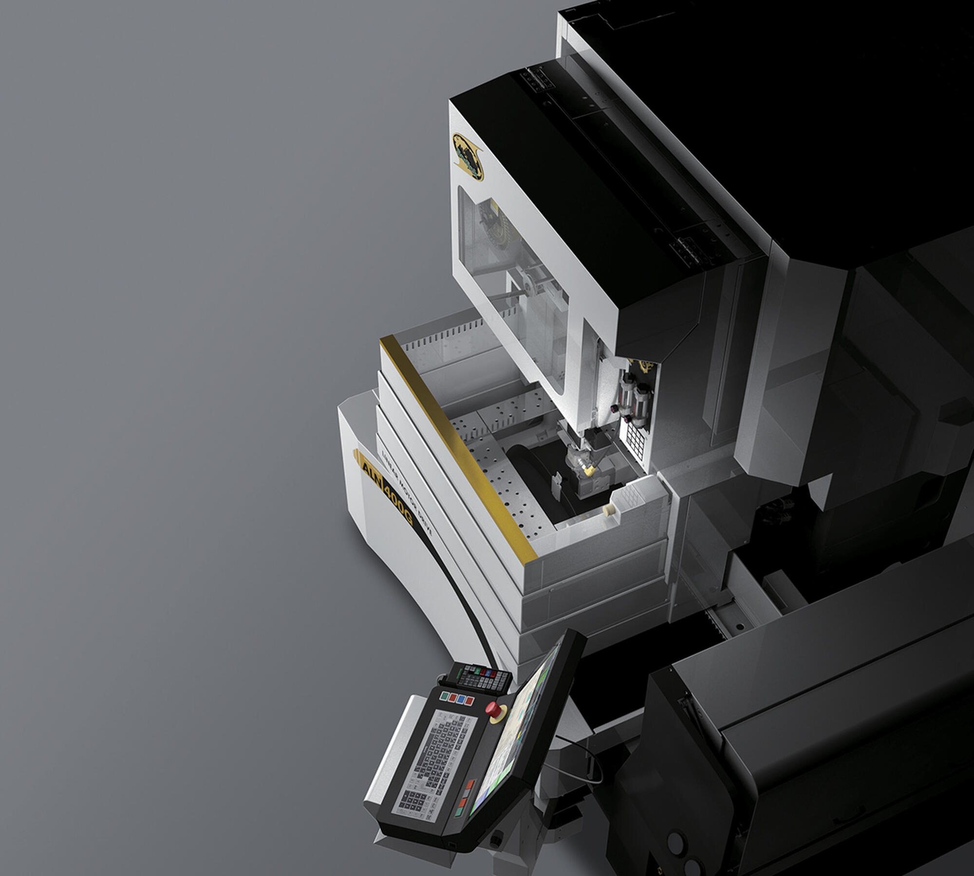

The ALN400G, a rigid linear motor driven high-performance Wire EDM machine, improves cutting speed and precision. How? By incorporating Sodick's next-generation Smart Pulse Wire control with the Smart Pulse Generator. The ALN also streamlines the control design, combining the best functions of both tablet interface and classic interface into a highly functional work display, improving processing responsiveness.

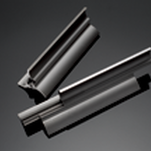

In cutting precision fitting parts with a 3.94" (100 mm) thickness, Sodick has achieved the following; improved cutting speed, reduced cutting frequency, improved part accuracy and improved surface quality. A 32% cutting time reduction has been achieved using the ALN400G.

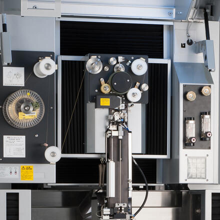

This AWT system allows submerged and non-submerged threading. Combining thermal wire cut for a straighter wire and new water-jet function, the reliability of the Sodick AWT system has been further improved. The exclusive use of closed guides on the ALN400G in combination with the FJ AWT further increases productivity.

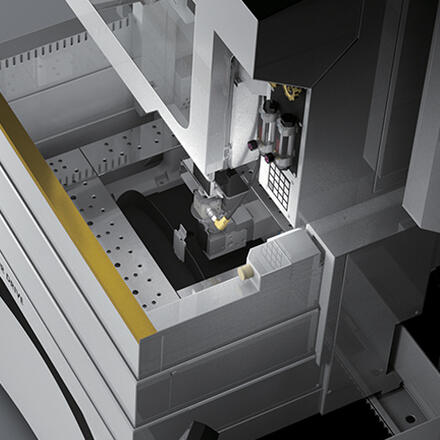

The 3-sided rise/fall worktank ensures a large set-up space and ergonomic accessibility. Since 3 sides slide down, the machine requires less operating space. The no-drip feature insures a clean shop floor, maintaining a safe work environment.
The fluid level is automatically adjusted according to the workpiece thickness and the operator can easily check machining progress even on thin workpieces because the slide tank can be stopped in intermediate positions while machining. The interior of the tank is made from stainless steel for quick maintenance (unpainted).
