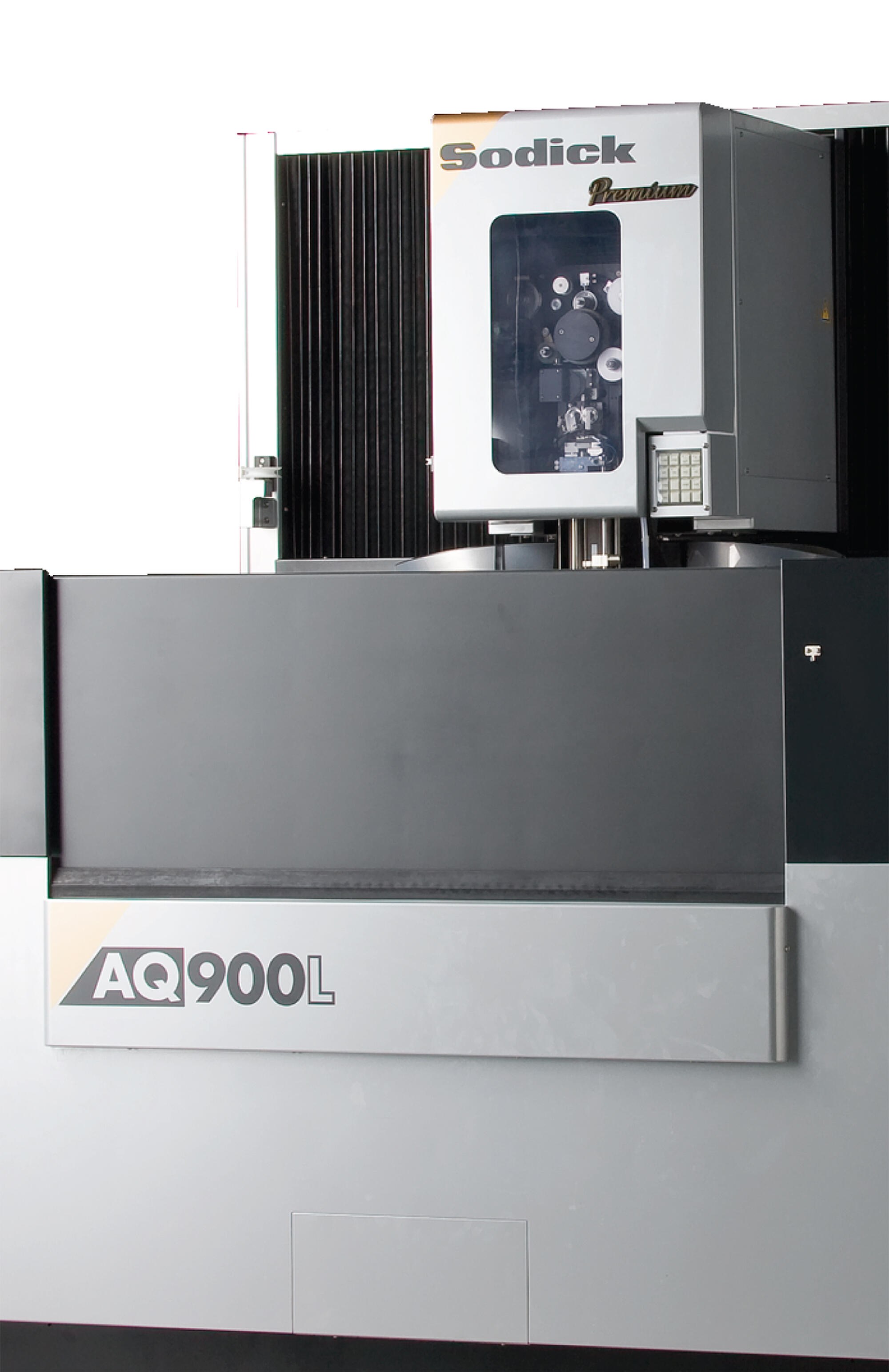

The AQ900L Wire EDM features Sodick’s Linear Motor Technology. The AQ Series is Sodick’s line of large work area and extreme taper Wire EDMs. The AQ900L is a highly rigid machine which is ideal for machining large sized dies.
Sodick’s AQ900L Wire EDM features linear motor drive technology. Linear motors provide smooth, vibration-free table movement, which results in unsurpassed positioning and machining accuracy. Backlash is completely eliminated since there are no ball-screws or couplings. With the use of linear glass scales in the X, Y, U and V axes, precision positioning accuracy with direct feedback is accomplished. This allows for unmatched straight and taper cutting accuracy. The longevity of this system is unmatched by anyone in the industry – and comes backed with a 10-Year Positioning Accuracy Guarantee.

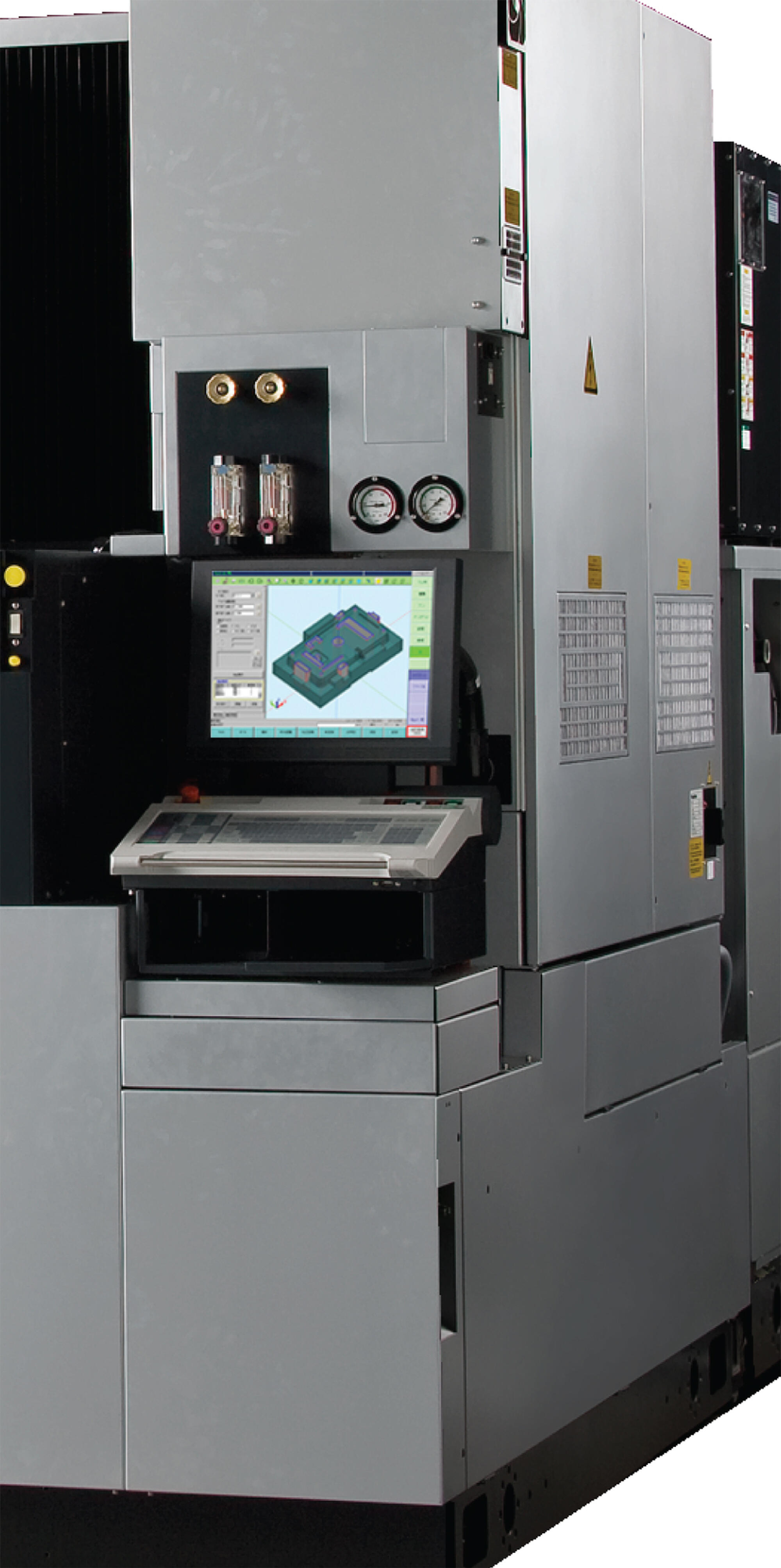

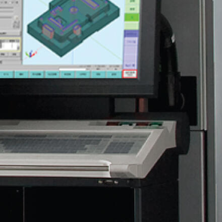

The AQ900L Wire EDM uses a high-speed generating LN Series control with a Windows platform. The system was designed to provide a user-friendly environment for the operator and still have the high-level functionality that is required in today’s demanding world. The control is network capable, this allows for NC sharing, remote monitoring, and messaging via LAN (option). The LN Series Control automatically generates cutting conditions, offsets corner control settings, wire speed, wire tension and other data necessary for proper operation. This is especially helpful to novice EDM operators, since no prior knowledge of EDM is needed to achieve excellent results.
